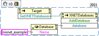

If they want to add a database to the system definition, they can do the following:
To add a signal  is a little bit more involved:
I attached a documentation to help you.
