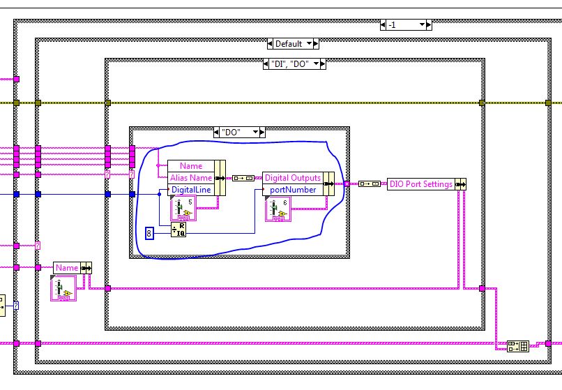

Keep in mind that you're asking how to modify a fairly complex example...you should probably just learn the code...
However, from looking at it quickly, it looks like the example calculates the port for you based on the DIO address based on 8 lines per port. If you look within the example VI, and then within "Convert Excel to NI Cluster.vi" function, you can see where it's making that calculation:
So, you could either let it continue to calculate your port for you based on the line number you specify, or you could add additional code in there to allow yourself to specify it. Hope that helps!
