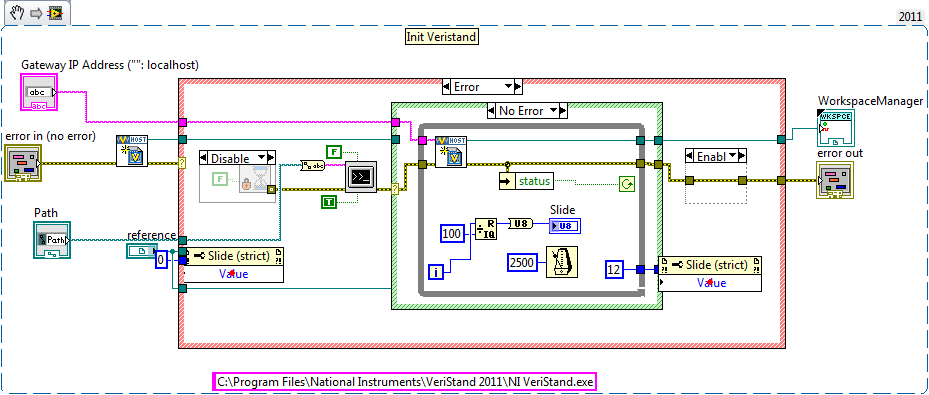

Yes,
I have attached a picture of the code.  This will launch VeriStand gateway server programmatically, but not silently.  I think there is something simular in one of the demo projects that ships with Veristand.  The heart of this is the system exe.vi found in Conductivity->Libraries and Executibles.  Hope this helps

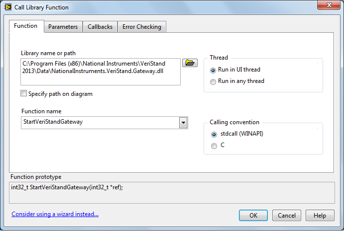

Is it possible to launch Veristand with "Call Librairy Function Node"?
I try this with LV2013, but it don't seems to work :
Has anyone already do this?
