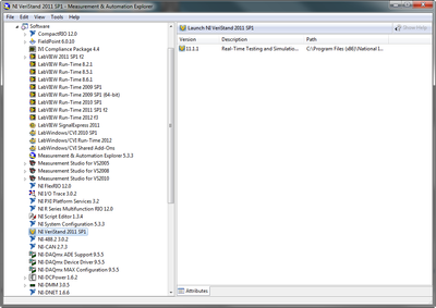

On MAX my configuration seems like this:
NI VeriStand 2011SP1 - Measurement & Automation Explorer_2013-03-05_08-53-32.png

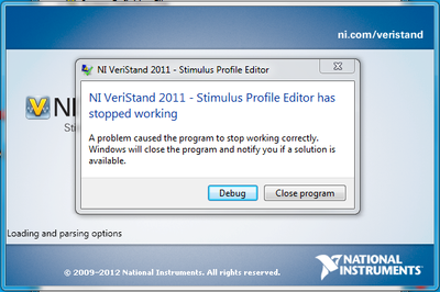

Hello NestorG,
I have replaced the files you have uploaded. Now I am geting Windows error.

Also here you can see software version that shown in MAX:
Veristand Version : 11.1.1
