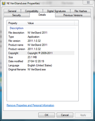

Without patch I couldn't run stimulus profile editor. You can see file version information, Stimulus Profile Editor.exe.config and windows error report screen shoots:
NI VeriStand.exe Properties_2013-03-16_22-51-36.pngStimulus Profile Editor.exe Properties_2013-03-16_22-38-32.png

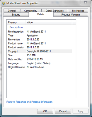

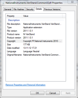

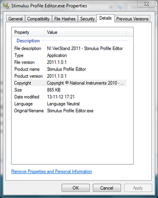

 After I have patched Ni VS 2011SP1 using Ni Update Service, Ni VS 2011SP1 Stimulus Profile Editor still not working. You can see file verisons, Stimulus Profile Editor.exe.config and windows error report below:
NI VeriStand.exe Properties_2013-03-17_14-42-28.pngStimulus Profile Editor.exe Properties_2013-03-17_14-42-46.pngNationalInstruments.VeriStand.CommonUI.dll Properties_2013-03-17_15-18-10.png

The images\info you have shown all appear to show a valid installation of NIVS 2011 SP1 f1. Nothing looks out of the ordinary which would cause the exception you are getting upon launching SPE.

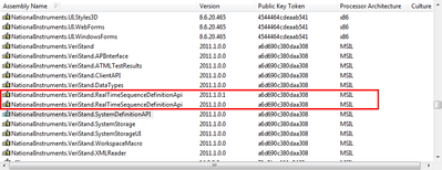

I have two NationalInstruments.VeriStand.RealTimeSequenceDefinitionApi.dll file in "C:\Windows\Assembly" location. You can see below:

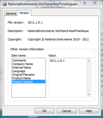

And Properties (Versions) of those files seems like below:
NationalInstruments.VeriStand.RealTimeSequenceDefinitionApi Properties_2013-03-19_10-11-18.png NationalInstruments.VeriStand.RealTimeSequenceDefinitionApi Properties_2013-03-19_10-11-42.png
