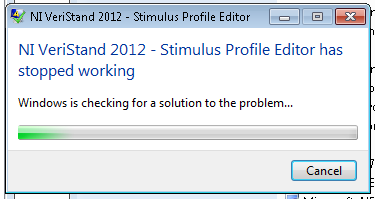

I am encountering the same problem also. To your question,  crash occurs when opening SPE, with file or just launching SPE from Project Explorer.
I am using NIVS 2012. Here is the screenshoot:
Can you please help me?

Hi Rajamodol,
The issue h_yong, YBilgin and most likely Hreidmar faced was particular to NIVS 2011/SP1. Essentially they had recursive calls in sequences which caused a stack-overflow. This particular issue should not occur in NIVS 2012; nevertheless, let's remove that from the list of items to debug:
  1. Move everything in the following folders to the Desktop.
    • <PublicDocuments>\National Instruments\NI VeriStand 2012\Stimulus Profiles
    • If you believe you also modified the NIVS sequence libraries, then also move these.
      • <ProgramFiles>\National Instruments\NI VeriStand 2012\nivs.lib\Sequence Library
  2. Relaunch SPE. Does it continue to crash?
Some additional questions:
  1. Does the crash occur with a specific sequence file?
  2. Are you able to create a new file and open it successfully?
Nestor

Hi Nestor,
Thank you for your help!  Here are what i did to your tips:
     I did it. I move both folders to desktop.
2.  Relaunch SPE --> Crash.
To your additional questions:
  1. Does the crash occur with a specific sequence file? --> No, it occurs generally, even with new project.
  2. Are you able to create a new file and open it successfully? --> Crate new project in NIVS2012? Yes, it works, but launching SPE still crash.
Unfortunately, i already completely reinstalled LV2012 and NIVS2012. So, i have no more issue regarding to SPE Crash.  I 'll come back then when i have this issue..
