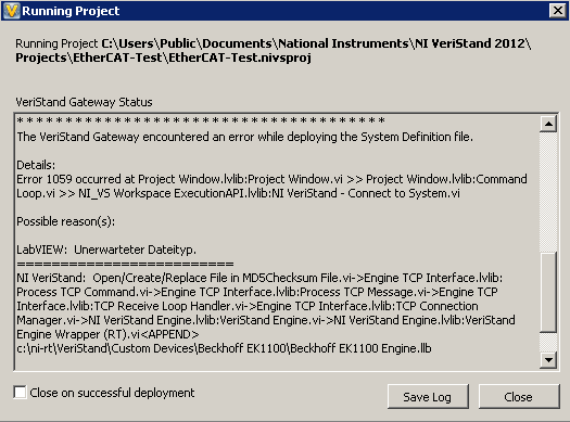

I don't know why, but now the following error appears when I try to deploy the VeriStand Project:
Does anyone know what could be the reason for this message?

In the meantime, I figured out, what was going wrong. The reason of the first error was that I just built the Configuration and not the Engine. The second error (screenshot from the last post) could be fixed by connecting via ftp to the real-time target and deleting the folder /ni-rt/VeriStand/Custom Devices/Beckhoff EK1100. Now everything works fine. Bizarrely, my LabVIEW code wasn't the problem. Smiley Happy
