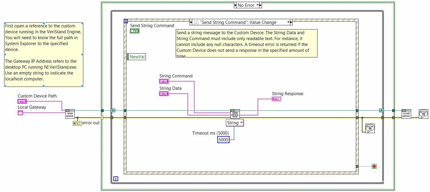

So I used the Open custom device reference.vi and the Send custom device message.vi, it works if it is launched outside Veristand, directly inside Labview.
see the Picture attached : Open Custom device reference - WorkSpace Tool.jpgOpen Custom device reference - WorkSpace Tool

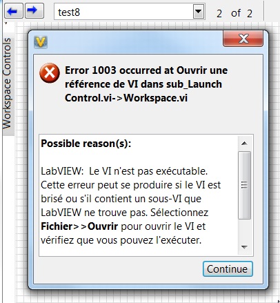

Indeed if I add this solution in the "display templates / Free decorations" , to make my own WorkSpace VI, An error (1003) occured:
see the Picture attached : solutions Added to Free decorations.jpg and Error occured in Veristand.jpg
Do you know why ?

Correct me if I am wrong, but you are building your own VI. Does this VI has a broken arrow ?
Are you creating an executable ?

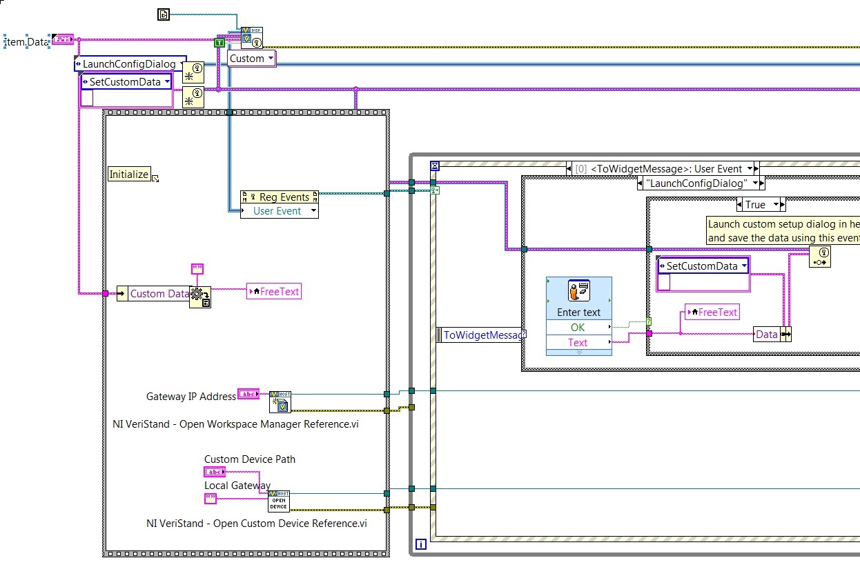

I didn't create any Sub VIs to make my custom Control VI so I do not think I have to create a source distrubutions for this. I just use the followings Vi which are integrated in the Veristand tools in LabVIEW :
 - NI VeriStand - Open Workspace Manager Reference VI
 - NI VeriStand - Open Custom Device Reference VI
The code of my custom Control VI  is attached...
The custom device is executed on the local Host PC.
