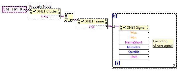

in this way you can get the infomation of signal_Encoding_tables
regards
Melo
