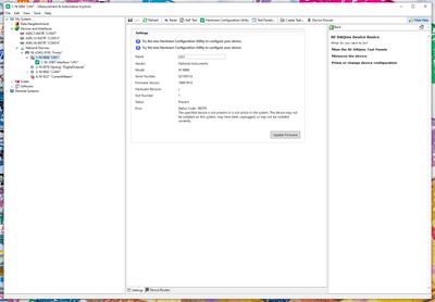

Hello.  I am using a cDAQ-9185 and have installed a NI-9866 for LIN communication.  When I go to use the bus monitor or do other things in MAX it says Status Code -88705 "The specified device is not present in the system ...".  I get the same status with another 9866, but I do have other devices in the chassis that are working correctly.

Turned out to be the slot in the chassis.  Moved the card to a different slot and it worked.  I don't know if there's a problem or if slot 1 just supports less.
