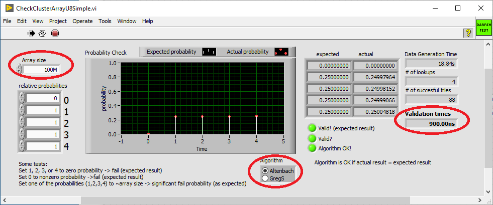

Yes, both work fine in 2015 and are about the same speed (~too fast to measure reliably!) Times are heavily quantized to a few values (e.g. 400, 800, 1200ns) and if the input is incorrect (e.g. if the first element is zero), it is still not really faster, meaning the loops are about the same speed as an empty case structure. 😄
I changed the array to a cluster containing a single U8 element to be able to test 100M size arrays, and it is still <2us (generating the data however takes 20s! :D) (this is on my old Laptop).
(Mine was actually slightly slower initially, mostly because of using a loop for the 1,4 pre-test. Apparently the compiler does not unroll that simple 2-iteration loop and thus adds some overhead. I tweaked a few other things, but we seem to be near the speed of light. :D)

As you probably noticed, I spend 90% of my efforts creating a reliable test harness to make sure it works under pathological inputs (2 or 3 missing, mostly 4s, etc.). Since I have it, why not share it. Here's my latest version, directly comparing GregS and my code (I also fixed some mislabeling and got rid of that ugly orange. :D) I also clear indicators when called to avoid staring at stale results. (LV 2018 now)
On my AMD Ryzen 1700x, I get submicrosecond times for 100M inputs. Seems fast enough 😄

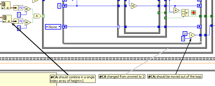

Nice to see you even took the time to suggest code improvements - thanks.  It shows in one snapshot the difference between a CLA and a lowly pleb programmer...
There were just minor notes mostly for myself. Did not actually make changes in order not to accidentally break or change anything (and out of respect). 😉
