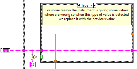

A colleague called me over to help him with a jig that he fired on for the first time since the Christmas holiday. The test software was written by a former colleague, and whilst I don't officially support it, I have been dragged over to have a look at it occasionally, holding my head in my hands as I do.
I managed to trace back the error code being reported to the RS232 barometer. A hastily written test panel showed it was responding correctly, so flicking through the code found me here:
I understand that there was a failure mode whereby the device returned odd string values (units are in Pa, so typically should be 101 000 or so), hence the attempt at a trap for unexpected values. I have never seen anyone use a GTE comparison on a string to check this, as only the first two characters are compared. Values between 100 kPa and 170 kPa are passed correctly; values between 17 kPa and 100 kPa are not.
As atmospheric pressure is hovering around 98/99 kPa, which is hardly unexceptional around here, and there is plenty of turbulent air in the vicinity of the barometer, it's a teeny tiny bit of an oversight. I'm just surprised they've never seen the issue before!

I had no idea you could even do a GTE comparison of strings. Is it just comparing the ASCII values?
Message 1904 of 2,635
(11,058 Views)
Comparisons on string behave strangely. It checks the first character of both strings, if greater, result is true, if less, result is false, if equal, check second characters. Repeat.
I'd agree, it makes a lot more sense to convert to numeric first then do the comparison.
How else would the sort 1D array work on strings?

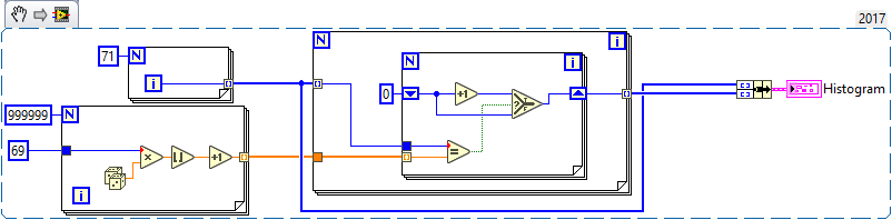

The task is to create a histogram of about 1M random numbers from 1..69.
We could do it with four FOR loops with the inner FOR loop pumping hot air most of the time (seen here)....
RNGHistogram
Or we could do it all in a single loop ....

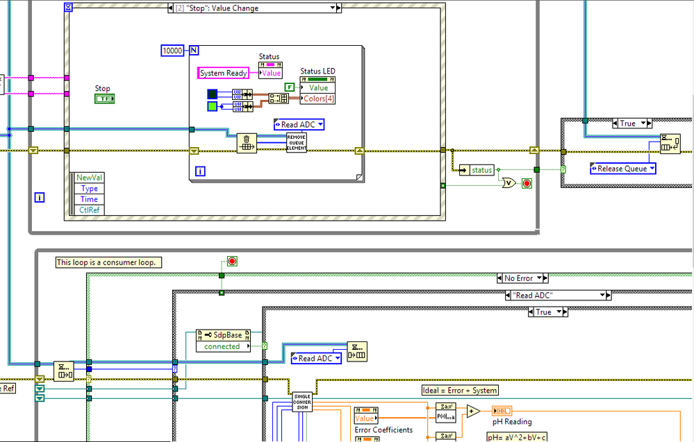

We ordered an evaluation kit for a particular component, and the manufacturer provided a nice GUI to test it. I was excited to discover that the code for their application is available for download on their website. Then I looked at the code and found this unusual approach to stopping a queued state machine:Flush Queue 10000.png
Spoiler
The Read ADC case constantly enqueues "Read ADC". How do you stop it? Flush the queue, remove all the "Read ADC" elements, and put everything else back in the queue. But what if the consumer loop executed again while flushing the queue? Better flush the queue again (and again, and again) - 10000 times - just to make sure.
It's the Drano algorithm. 😄
