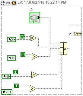

wiebe@CARYA wrote:
@BertMcMahan wrote:
While this isn't exactly OVERLY complicated, it's something I shamefully admit to doing when I first started teaching myself LV. I didn't know about Case structures, and needed something to execute or not based on a boolean, so here's my janky boolean solution:
Not bad, not bad at all. It saves a click to see what's in the other case, to make sure or to find out it's empty!
I have not investigated it recently but NI did have a Patent on a 3-D diagram that provided your perspective of the diagram was right, you would be able get a glimpse of more than one case at a single glance.
Ben
Message 1992 of 2,635
(12,778 Views)
True greater than a boolean?  I had to run some test code to find out that it gives the same result as a NOT.
Seen here.
28.6.18_BD
Message 1993 of 2,635
(12,659 Views)
And the NOT can of course be implemented as invert on the compound AND.

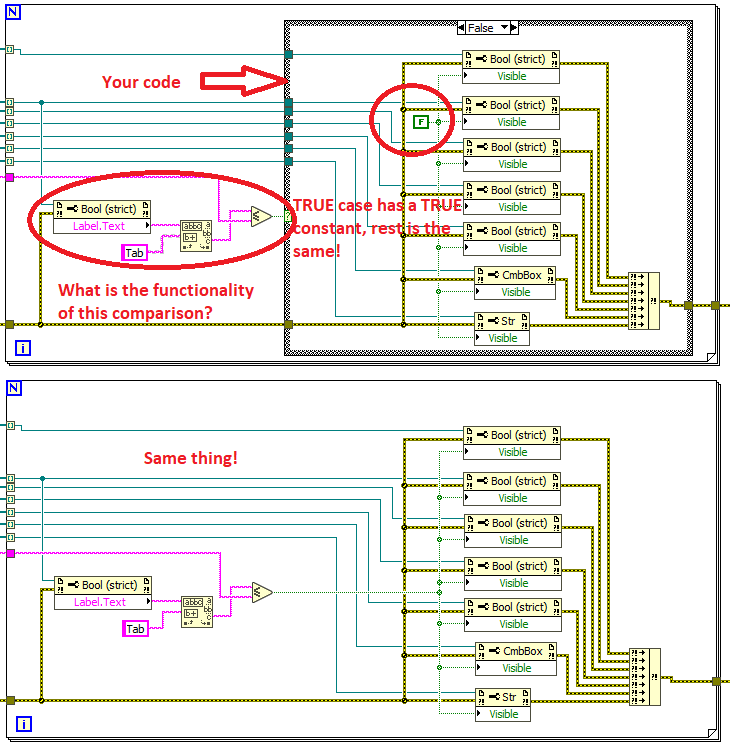

So we have a case structure (boolean selector) where the contents of the two cases are identical, differing only by a boolean diagram constant that we already have. (See here)
I don't think that case structure is needed at all!

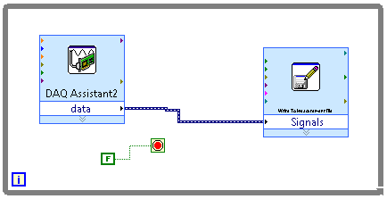

Rube Goldberg code often looks complicated, so for something a little easier to look at, here's deceptively simple Rube Goldberg code.
(The poster claims 1 year "LabVIEW experience", whatever that means. Maybe in another few years he might stumble across the stop button by accident :o. We just need to be patient! :D)
(Seen here)
Message 1996 of 2,635
(12,415 Views)
(Seen here)
Really Christian,   haven't you ever seen the Abort Button?  😄
Damnit it's hard to type in a phone when you're screen is covered in coffee because you forgot to swallow before reading a post
Message 1997 of 2,635
(12,401 Views)
@JÞB wrote:
(Seen here)
There's even a button on my computer case that seems to work just fine if I press it long enough. 😄
Message 1998 of 2,635
(12,396 Views)
