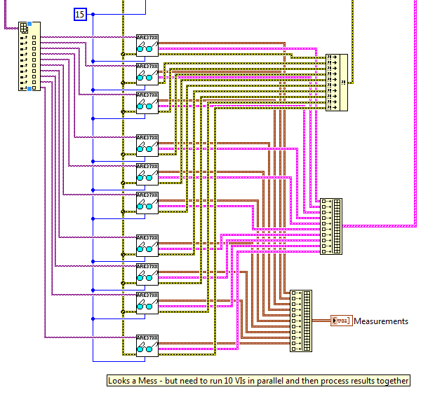

Ok - I will admit that this is horrible.
This is my code and it makes me sick. I'm sure it's a Rube but I can't for the life of me work out how to un-Rube it.
10 functions all identical all doing COMs with 10 different Instruments of the same type. Need to run as fast as possible and probably have limited memory due to complex maths funtions taking place elsewhere on arrays.
(SubVI and all subfunctions are re-entrant to ensure parallelism)
Surely this is a rube - any ideas on how to fix it?
James
CLD; LabVIEW since 8.0, Currently have LabVIEW 2015 SP1, 2018SP1 & 2020 installed

What if you would use an autoindexing parallel FOR loop and configure it for 10 parallel instances?
Do you have 10 different serial ports?
Message 1458 of 2,635
(11,518 Views)
I do have 10 different serial ports - what is this
" autoindexing parallelFOR loop "
I think I am missing something here
Message 1459 of 2,635
(11,515 Views)
Found it - thanks Genius!!
