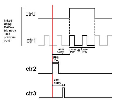

Below is a basic timing diagram for a single iteration, bearing in mind this needs to be repeated in the range 100-1000Hz, approximate pulse widths (PW) would be 2 microseconds and the delays in the region of 500 microseconds.
I need to be able to define
cam delay and laser delay accurately (and the pulse widths should be easy in theory)

The application is Particle Image Velocimetry, which allows for a flow field to be visualised by illuminating a seeded flow using a laser. A double-pulse mode camera is used (IDT MotionPro X3), which takes two images in rapid succession per cycle (e.g at 500Hz with 100ns between exposures for the two images). This needs to be synchronised with two laser pulses. The FPS pulse is used to ensure that the power in the two laser pulses is equal.
Thus per cycle, I need a camera trigger, an FPS trigger and two laser triggers, thus using all four counters, as in the timing diagram. The timing is very important as we will be working with very small scale channels (in the region of 50-150 microns diameter) and thus it is important to use hardware timing. If this is not possible without the digital lines for triggers, then I could probably run to a CB-68LP connector box. What do you think?

We could just trigger everything off of counter 2 (the FPS pulse that seems to start the whole acquisition).
CTR 2 would be a continuous pulse generation (at the rate we want to re-trigger the whole process).
CTR 3 would be a single, retriggeralbe pulse generation with an initial delay.
CTR 0 and 1 are a bit tricky in the context of the rest of the application.
I think that the suggestion I posted in the previous thread should work properly by making CTR 0 re-triggerable with an initial delay.
