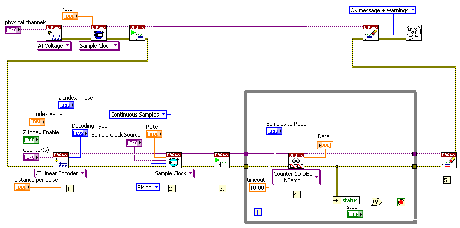

I'm working on taking position measurements with a cDAQ-9172 chassis with a NI-9401 high speed di module in slot 6 for my counters.  My encoder is a DRC optical linear encoder.  First thing I've noticed is my encoder only reads in properly if I choose two pulse counting, which doesn't make a lot of sense to me, but that is besides the point.  When I configure my LabVIEW code (v8.5), everything reads in fine, but I loose counts when i'm traveling.  My counter doesn't return to its starting point when i travel from stop to stop and back i don't always return to my starting point (in this case, 0).  I can't believe that i'm moving my encoder faster than the module itself can read.  However, if i move at speeds anything over about 4 inches per second (10000 counts per second), I will not return to the same count or distance that I started at.
I have a subvi setup that creates my encoder channel.  I've attached a jpg of the block diagram.  I just changed my sample rate for my sample clock to 1e7, from some other large random number.  If anyone has any ideas, or needs any more info, cause i'm not real good at conveying this stuff in an email, let me know.

If I understand your problem correctly, you are using your NI 9401 module and the 100 kHz timebase provided by the NI 9172 cDAQ chassis to sample and record the position of an encoder. You are using the previous post’s attached “Measure Linear Position…” example for LabVIEW. However, when you run this example, you sometimes receive error 200141. There are other modules in your 9172 chassis, including an Analog I/O module. Is my understanding correct?
Error -200141 indicates that the position data you are writing to the module’s FIFO is filling the buffer faster than it can be moved to your computer’s RAM and data is being overwritten. Since the 100 kHz sample clock is not a requirement of your application, you can try utilizing another sample clock to fill the FIFO at a slower rate, allowing the data to be moved before it is overwritten and thereby removing this error.
A way to provide this sample clock is to create a mock DAQmx task in LabVIEW that uses a sample clock and then reference that sample clock in your counter task. Since you already have an Analog Input module in your cDAQ chassis, I would suggest creating an AI task. An example of how to modify the block diagram can be seen in the attached screenshot “Add mock AI Task.”
The AI task is configured and started, then cleared after the counter task is complete and no longer needs a sample clock. On the front panel of the example, in the Timing Parameters box, you would select the Analog Input Module’s sample clock as the Sample Clock Source. This can be seen in the attached Screenshot “Timing Parameter Front Panel,” where an AI module was in slot 3.

Thanks a lo four your reply. I'd some problem, in first with your vi, because I put in source "cdaq1/mod3/ai/sampleclock" and I got a error about material compatibility and the right way is "cdaq1/ai/sampleclock" mod3 is slot where is my ai card, but is to much in the cadencement source.
So, the application, now, run corectly.I used max to realise the task, so when this application will be complete, I will send my complete configuration, I think it's a good example about problems we can met on cdaq rack.
