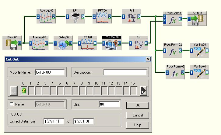

I get one more question about how to use the Global Variables. I want to use the Global Variables in the Cut Out module as shown in the figure.  What I really want to do is calculate the Global Variables before using them in the Cut Out module, which means whenever the Global Variables changes, the Cut Out module follows their change. I put a time delay in the program, but it seems not doing the right job. What else can I do to achieve it?
Many thanks,
Alan
dasylab
Message 7 of 11
(9,036 Views)
The help suggests that this module only reads the variable at the start of measurement, and does not update it dynamically.
"You can enter the identifier of a global variable via the shortcut menu which DASYLab reads out at the beginning of a measurement."
Measurement Computing (MCC) has free technical support. Visit www.mccdaq.com and click on the "Support" tab for all support options, including DASYLab.
