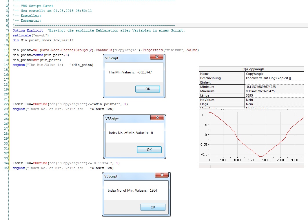

During the work with Diadem I got two troubles. Could you please take a look and show me the wrong if you find the issue?
1.) Here is my trouble as we see the photo below. It is most important problem which I have. I really have no idea why it could happened. It is alway happened to find a value with decimal type's variable, and even that variable is changed  to "str()".
setlocale("en-gb")
dim Min_point,Index_low,result
Min_point=val(Data.Root.ChannelGroups(1).Channels("CopyYangle").Properties("minimum").Value)
Min_point=round(Min_point,6)
Min_point=str(Min_point)
msgbox("The Min.Value is:   "&Min_point)
Index_low=Chnfind("ch(""CopyYangle"")<="&Min_point&"", 1)
msgbox("Index No. of Min. Value is:   "&Index_low)
Index_low=Chnfind("ch(""CopyYangle"")<=-0.11374 ", 1)

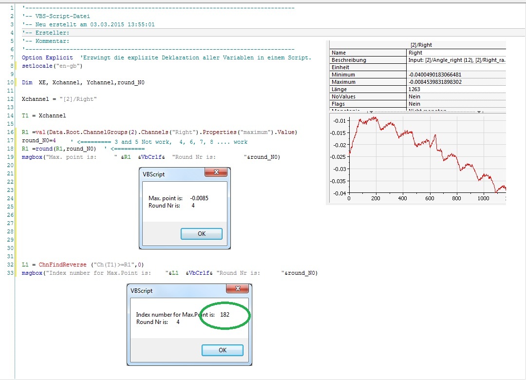

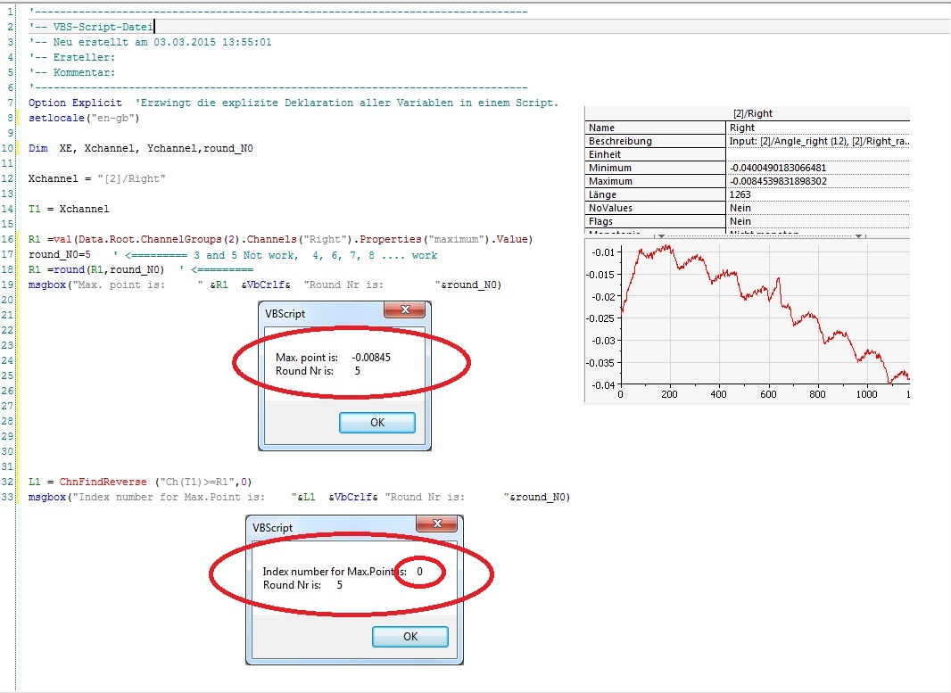

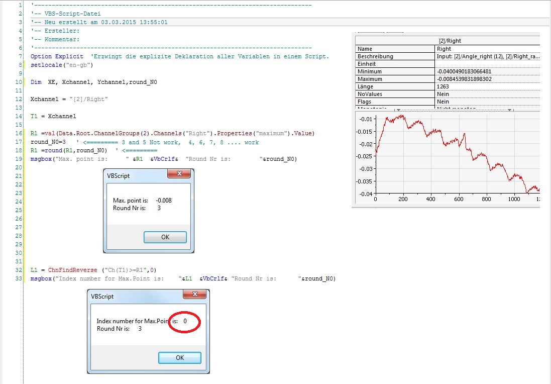

2.) Still the problem with ChnFind()  or  ChnFindreverse().   If I change the Rounds off a number to the nearest integer with the function "Round()" it might not work in ChnFindreverse(). Such like it works under 4, 6, 8 and even 7 but doesn't work with 3 and 5. Is this logical?
setlocale("en-gb")
Dim  XE, Xchannel, Ychannel,round_N0
Xchannel = "[2]/Right"
T1 = Xchannel
R1 =val(Data.Root.ChannelGroups(2).Channels("Right").Properties("maximum").Value)
round_N0=4   ' <========= 3 and 5 Not work,  4, 6, 7, 8 .... work
R1 =round(R1,round_N0)  ' <=========
msgbox("Max. point is:     " &R1  &VbCrlf&  "Round Nr is:        "&round_N0)
L1 = ChnFindReverse ("Ch(T1)>=R1",0)
msgbox("Index number for Max.Point is:    "&L1  &VbCrlf& "Round Nr is:      "&round_N0)

I downloaded the files and was able to get it to work. It looks like when you format the minimum value to a string, you loose precision and then ChnFind doesn't find the value your are looking for. He is an example which worked for me :
Set oChnY = Data.Root.ChannelGroups(2).Channels("Right")
sgValue = str(oChnY.Properties("minimum").Value,"d.ddddddddddddddd")
Index = ChnFindReverse("Y<="&sgValue,,Array("Y"),Array(oChnY))
LogFileWrite(Index)
 Using symbols (parameters 3 and 4) is not necessary to get the solution. The key is teh second value for "str" which formats using more digits. As soon as you reduce the number of digits, you may no longer get a result.
