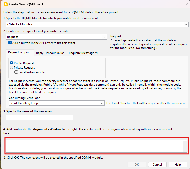

What is the purpose of this box?

Hi Michael,
Looks like it is a field to add a description of the event you are creating.

How can you tell?

(2,682 Views)
Good finding - the box description
5. ???
is missing.
Message 4 of 9
(2,664 Views)
So it's missing a label but to confirm the field is for the description I typed in something and found the text gets added to the VI description field of the request VI.

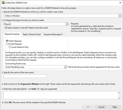

On my system (1440x900, 100%), the dialog box looks like this:
Could you please share your OS, screen resolution, scaling, and anything else you think might be helpful? Thank you!!

Hmm, the plot thickens. I'm running Windows 11, 1920x1200 resolution with 100% scaling.
I notice that Item #4 is wrapping on my UI, but not on yours. I wonder if that is a clue.

It's a font difference between the systems. Here's the word "These" in item #4 on Joerg's image:
And here's the same from Michael's image:
That extra pixel between the "T" and the "h" is just enough to push the text onto the next line. Since the free label containing #4 and #5 in the instructions is sized to 3 lines, the #5 text is being pushed to a 4th line that isn't visible.
Given that these are hard-coded fonts, I assume there's some Windows setting that causes them to render differently. I don't know what that setting is.
At any rate, I think the fix for this would probably be just to widen the #4/#5 free label a tiny bit to accommodate the extra pixel.
