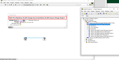

Hi all,
we try to use PPL with DQMH, as followed by this video tutorials by Matthias: https://www.youtube.com/watch?v=Oet7SLmQOzo&t=1269s.
but when using the PPL, the Enqueue message function is missing, "VI fail to compile" in Error list.
Any suggestion?
Many thanks in adance

thanks, but it did not work.
again we build PPL in other PC with almost clean OS just Labview 2017 and DQMH installed, using both Exclusion settings, the result is all the same.
