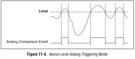

If you're not using Analog Input, you could configure an AI Start Trigger on the APFI line.  This will route the APFI line to the internal comparitor--the resulting signal is called the Analog Comparison Event and can be used as a clock for your digital task.  See the below diagram from the M Series User Manual:
21902i405ED22612A128D9
Even if you are using AI, if you don't mind starting it based off of this clock signal then this could still be an option.  It's not exactly straightforward, but it might be easier than reworking your custom PCB.
