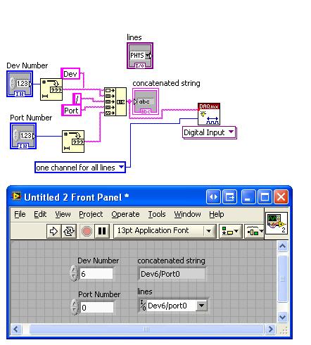

I wish to programatically define DIO 96 ports for either input or output using LabView Daqmx. It seems a good way is to have a select case function one for Create Virtual channel input, one for create virtul channel output. The 'Lines' input can be used to define a channel, but how can I programatically define the port name (0..11) (channel) that I require for say an input? It seems that the 'Line' input is strange data type, although the 'Create Virtual channel' seems to accept string inputs without an error being generated, but does not seem to respond to them either; what is the format needed for the 'line' input?

You are correct. The DIO 96 does not feature line-configurable ports. This means the methd to use is the case structure with DI and DO Create task VI.
The lines input is its own datatype, but it can be coused from a string. The string just needs to be built the same way as the constant from the block diagram. i.e. Dev1/port0. Then consider something like the DAQmx Get Terminal Name with Device Prefix.vi found at \LabVIEW 8.6\examples\DAQmx\_Utility\_Utility.llb\. This vi takes the string and wires it to the DAQmx Line Datatype indicator. Then you can just have the correct datatype. But, it should work with just a string.
Is this what you meant? Or did you mean can you pass a number to something to 'select' (create) a DAQ task?

Yes this is what I wanted, thanks for that.
