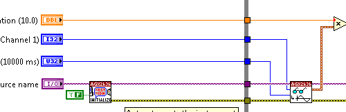

Until I used these drivers, it couldn't deal with negative values from the scope and displayed very odd waveforms + it always reset the scope when one ran the vi!!  The new drivers form the link fixed the negative values issue and i managed to stop it resetting the scope by putting a constant 'false' on the reset input to a VI.

Actually, the Autosetup.vi is equivalent to the "Auto Scale " button on the front panel. So if you are going to fetch the math channel, it is will clear the math channel if you auto scale before fetching data.
According to your scenario, it is highly recommended to modify the example VI by removing the Autosetup subvi. The updated VI looks like below.
Charles

As it was, it didn't clear the math channel on the scope, in fact it did't appear to do anything to either scope or vi dsplay, just generate an error immediately I run the vi.
I removed the autosetup just now as you suggested and the code now captures a screen of Math channel (FFT in my case) but then generates an error:
