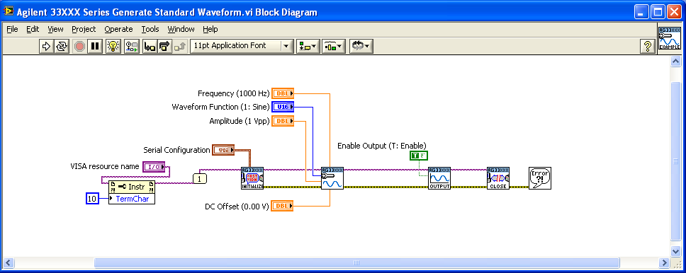

Dear Dennis,
Thanks for the help so far, but I am pretty new at this (labview and everything else) and don't understand much about GPIB. I did the search and read posts about termination code, and one of the post (i think it was actually yours) says I have to append the commands by CR/LF. This is what I did to add the termination code, but since CR and LF are two seperate characters, I am not sure how to go about doing this. Sorry for the newbie question.
Also, since the cable is not really GPIB, but a virtual port, does this mean I cannot use the blocks from agilent 33xxx library?
23562iEA1E5E5BA97CB23C
Message 9 of 13
(6,887 Views)
To append CR/LF, you would have to find each every VISA Write and use the concantanate string function on all the existing command strings.
