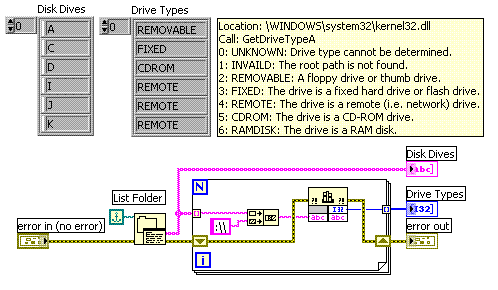

It is simple in LabVIEW to get a list of disk drives on a given computer as shown:

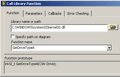

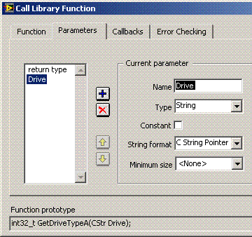

There are round about ways to get drive information such as command prompt and the system exec.vi and registry vi’s. These methods require a lot of overhead and programming. There is currently no simple function in LabVIEW that I can find that will return the properties of a disk drive.
