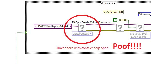

So I was looking at this VI here And was hovering over one of the missing VIs (no drivers installed here).
  1. If I hover over the missing VI and press ctrl+h, LabVIEW disappears instantly.
  2. If I press ctrl+h first, the context help appears, but If I now move the mouse over the missing VI, LabVIEW again quits. Poof!!!
100% Reproducible, tried 4 times. Ouch! Same for all other missing VIs I tried.

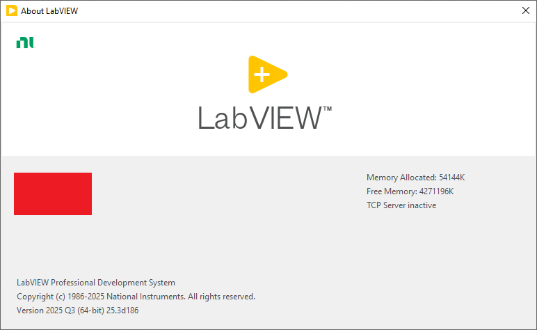

This is the beta forum and I am running 2025 Q3 (64bit), 25.3d.186
I would assume this is a new bug, else it would have been reported long ago (guessing).

I can confirm this behavior on my beta VM (25.3d.186), so it isn't just your install, at least.  Good to know it doesn't happen in NI's latest version.
Message 8 of 9
(519 Views)
I verified that this Bug was introduced in an earlier build of LabVIEW 2025 Q3, and has already been reported internally and fixed. The Bug number is 3079400.
