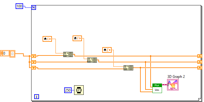

Well I am trying with my basic (very basic indeed) LV skills to do this: I made a VI that pics the values of an array containin lstitude, longitude and altitude values, processes this values and calculates the spherical coordinates (azimuth,elevation) and cartesian (X,Y,Z).

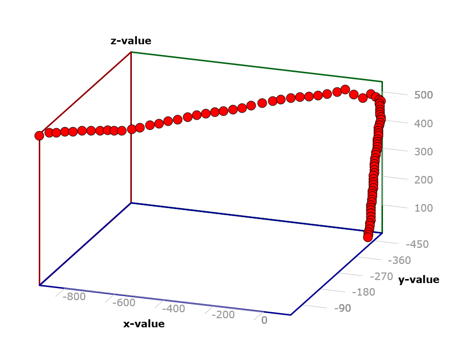

Then I was trying to represent X, Y and Z in a 3D line graph. I want to obtain something like this:

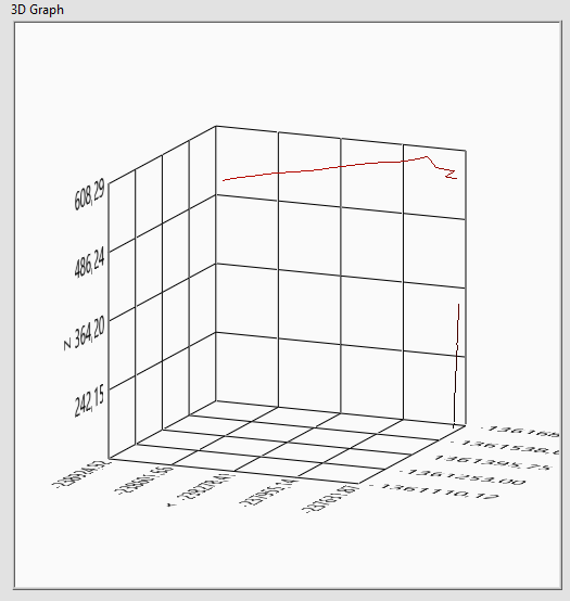

I am experiencing some issues and I think that is related with the axis scales but I can´t solve the problem.
This is wath I get:
Another problem is that when the loop ends the line disapears and the second time I run the VI nothing seams to apear in the graph and I need to view the line behavior when stoping.
Can anyone please give me some tips?
I also have my code bellow.

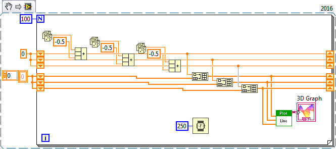

     I'm attaching a Snippet, written in LabVIEW 2016 (I notice you are using LabVIEW 2013, which I don't have on my system, but the diagram is simple enough you should be able to recreate it for yourself).  This does a "Random Walk" starting from 0, 0 for 100 steps, updating every 250 msec.  I'll explain, below, how it works.
The top three shift registers hold the X, Y, and Z coordinates of the current point, starting at 0, 0, 0, while the bottom three shift registers hold the X, Y, and Z coordinates of the evolving line.  Each loop, the "next point" is computed by adding a random number from -0.5 to 0.5 to the previous coordinate, then appending this new point to the line, replotting the (growing) line each time through the loop.  To keep the plot from "jumping", I set the Axes to -10 .. 10 and called for a Point Size of 3 and a Line Width of 1.

1- In my final VI I must replace the upper entry of the Build Array blocks with the new X, Y and Z values? Something like this:
2- Do I have to keep the top shift registers or the last value will be the bottom entry of the Build Array block?
3- Can I use a While loop to process a variable number of entries?

Bob,
I have made the changes you suggested. So, regarding the list you wrote:
So to fix this up, do the following:
  1. Put the Spreadsheet-to-Array function outside the For Loop, get your 2D Data ready.
  2. Don't wire anything to the For Loop's "N" input, but instead bring the 2D array of data into the For loop through an Indexing tunnel, which will deliver you one row at a time.
  3. Do whatever calculations you need to do (I strongly recommend you write a little sub-VI to hide the very messy details in your current code -- spreadsheet row array in, X, Y, Z out) and add the resulting X, Y, and Z values to the growing Array of Points-to-be-graphed.
  4. I believe you wanted to update every 500 msec, so change the Timer inside the For loop.
I did the steps 1, 2 and 4 without any problem. Then we have the point 3. I think that you want me to pass the X, Y and Z calculated values directlly from one For loop to the other For loop using index tunnels like I'm trying in the new version of my teste_array_2 bellow.
I think I have done something wrong because I can plot anything.
The version teste_array_3, also bellow, is working, using the local variables linked to the X, Y and Z but there is the problem of the 89 values.
Can you please tell me what is wrong in the teste_array_2? I think its the closest version to the one I nedd but there is nothing in the plot.

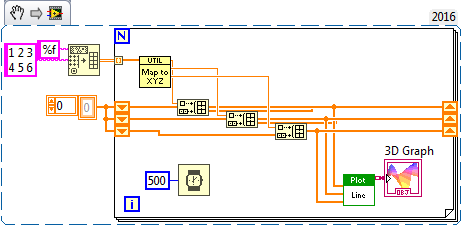

There's only one For Loop.  Each iteration through the loop, you take in one data points from your 2D array, create one point to plot, then plot it!  Like this:
Note that all of the "complicated" code that occupies so much Block Diagram space that it is hard to see the plotting (or, worse, hard to see that the plotting belongs inside the loop) is nicely "hidden" away inside the sub-VI Map to XYZ (which has a nice, easy-to-create VI Icon so you can easily tell what it should be doing).
I'm using a simple 2-row input array, of course, because I'm too lazy to type all of your 89 rows ...

Something I've said to many of my LabVIEW Advisees -- tell me what you want to do, don't tell me how you want to do it.  When you become a little more advanced (or take on more challenging LabVIEW Projects), you do what I'm currently doing -- Write the Documentation First.  [I've currently got about 8-10 pages, single-spaced, with only a little LabVIEW Code to show for it ...].
In your case, "What" you want to do is "Get a bunch of points into Map Coordinates, then for each Point, plot it on a 3-D Graph, connected to the previous points".  The key concept here is "For each ...", which implies a For Loop acting on "the current point and previous points", i.e. a single For Loop.
Another trick I often use (for myself) is to write a very simple version of what I want to do (like my Random Walk generator I first posted), then modify it as little as possible to incorporate what I really want to do (Spreadsheet to Array outside the loop + Map-to-XYZ inside).
BS
