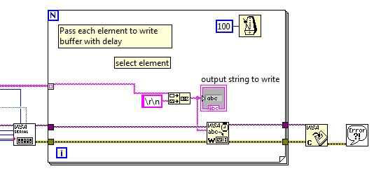

Hi Mark,
I assume that the wait VI is used to be certain that the AT-command has been sent and received, correct? The way you have written your code now, you generate one command, waits, and then generate another one, the delay will not have any effect when you send it. If you want to do several serial writes with a delay in between each AT-command, you must call the VISA write VI several times (now you only write once). Some sort of loop is needed, if it's a while or for loop could depend on the purpose of the VI. If you only want to send all the commands and that's it, I would go for a for-loop like in the figure:
21231iA05B30AF758BDF7A
If you continuously want to write/read then a while loop would be necessary.
Also, you need to control the dataflow in your VI, you can turn on Highlight Execution to see how your code is executing at the moment. When you run it, you can see that the local variable "output string to write" is sent to the VISA Write VI before the string has been generated in the for loop. By using local variables you don't get the same predictable dataflow as with wires and there is no need for a local variable in this VI, everything can be done via wires. There are lots of pages about Labview dataflow, just search at NI to get started.
Hope this help!
