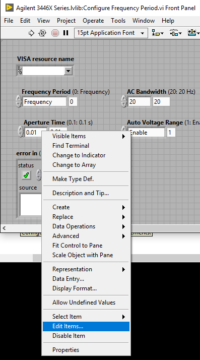

I downloaded the driver and it looks like the aperture time is limited to three values: .01, .1, and 1. The documentation says that the 34465A IS capable of .001. You can open the "Configure Frequency Period.vi" and right click the Aperture Time ring and add a new entry for .001 with a value of .001. Hope that helps.

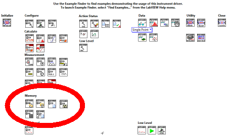

Just had a quick peek and the example that ships with the driver, "\Examples\Agilent 3446X Series Acquire Triggered Multiple.vi" might work for you.
But the driver does have VIs to read DMM memory and dump data directly to disk.  Look at the VI tree for those VIs.

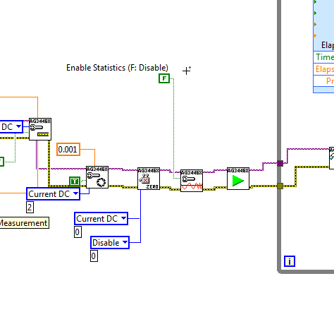

My readings from the get statistics VI are all going to 0 so i'm not sure what is going on.Inside it is writing the SCIP command CALC:AVER:ALL?
Can anyone see why?
Message 7 of 13
(10,227 Views)
You put the "Enable statistic" VI in the code, but didn't set it to true.  By default its False, so you must wire a TRUE, then I think you'll be good.

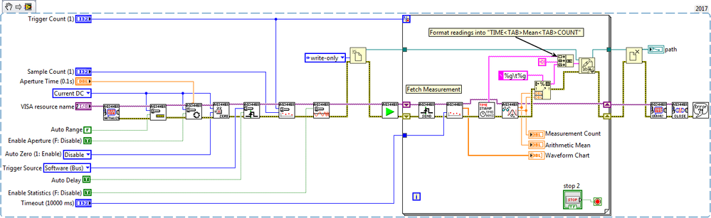

1: The average from the read measurement statistics VI only manages to work once, and does not update.
2: No matter what the average is, as read by the indicator, it still appears as "0" when I send it to the spreadsheet.
Message 9 of 13
(10,183 Views)
You only ever trigger one set of measurements in your code.  You would need to send a trigger with every iteration of the while loop.  Try something like this..
