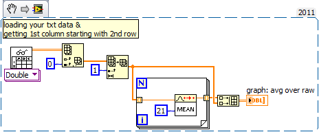

There are many ways to apporach this and the attached VI will show some possibilities (adapted from here)
The explicit subset average is probably closest to the desired functionality, it simply takes an average of fewer points near the ends, keeping the data size constant.
Here is a quick comparison. Modify as needed.
