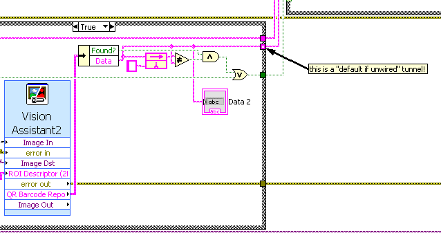

Hi ali,
well, you need to write them in one line instead of two…
You should not use "default if unwired" output tunnels on your case structures when you don't want to write empty strings into your table!
Message 2 of 30

Hi Qasim,
as said before:
DON'T USE "default if unwired tunnels" in your case structures!
Instead you should always output the last read result…

Hi zah and Qasim,
this is an example of what I'm talking about:
Btw: you should clean up your VI too. Using the AutoCleanup button might give a start!

Hi zah,
you have to provide a value to the tunnel in each case!
As said before in message #4:
