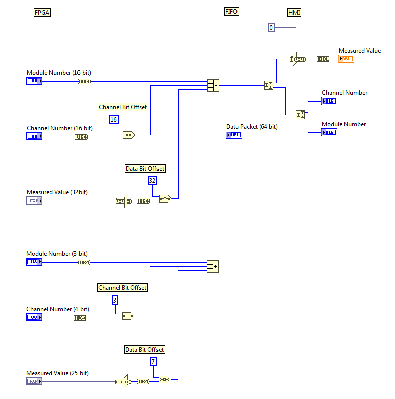

I'm trying to create some logic for sending N number of channels through a DMA FIFO. What I'm trying to solve this moment is how to add some info in front of the measured data.
Using a 32bit word, I want the first 3 bits to represent the module number. The next 4 the channel number, and then the final 25 bits the data.
The problem I'm facing is how to decode that information. I've got it working with a 64bit word, split into 16/16/32, however, I don't want to use 16bit words for the module number and channel number.
Do you have any suggestions on how I should be decoding my 32bit word?

If you need 3 bits, lets say bit 7, 8 and 9, rotate (or shift) 7 to the right. Bits 7, 8 and 9 are now bit 0, 1 and 2. AND this with 7 ( 111 binary) and you have your result.

Hi Peter,
start like this:
Using AND to limit number of used bits, using Rotate to shift bits, using OR to stuff bits into one longword…

Missed the use of the AND. Thanks for the help!
