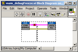

Block Diagram objects only copy paste as images, why & how to fix?
I have two VIs in a project. When I attempt to copy anything from one VI to the other it only pastes as an image. This even applies to labels. This occurs in either direction between the VIs.
What is causing this, how to correct or mitigate this and what is the recommended resolution?
