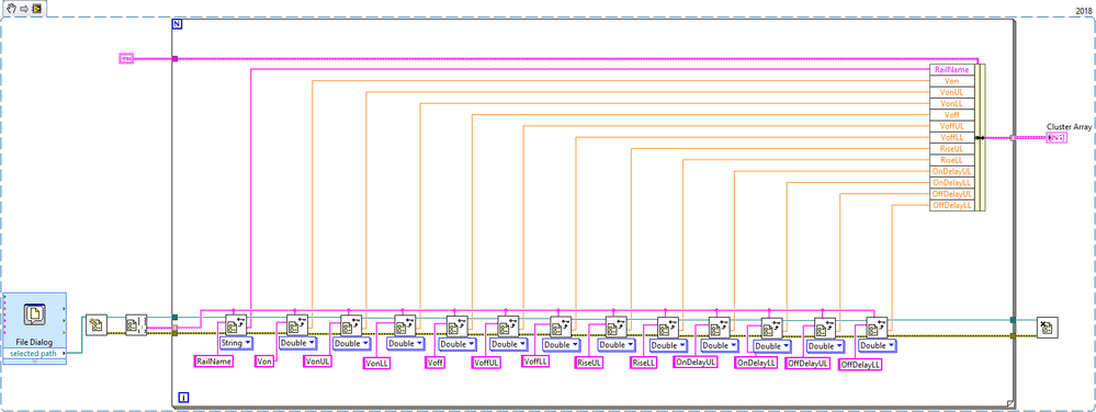

I am trying to see if there is a faster or more elegant way of building an array of clusters from an ini file.
I have several products each with different configurations I am testing.  I am storing the test limits inside an ini file and want to extra the information out to an array of clusters for test processing.
I am currently doing this in a unmaintainable way of just extracting the key-val pairs one by one.
Attached is the ini file I am parsing through.

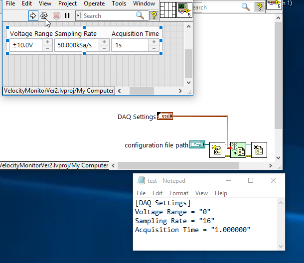

If you want to stay with INI files, you can download the OpenG Variant Configuration File Library from VIPM. You can wire a cluster directly to create an INI file; there is a Read function also. See below.
Note that Voltage Range and Sampling Rate are Text Ring Controls, so the numbers are correct.
mcduff

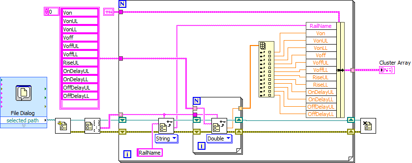

Definitely not faster, but still more elegant (and scalable!) would be to avoid all that duplicate code :D. Also make sure to use shift registers for the reference to protect for the case where the autoindexing array is empty.
