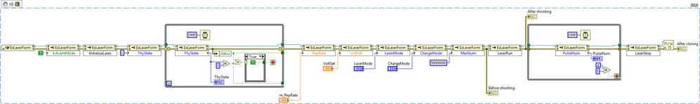

I have a rather large project that controls translation stages, a camera and a laser. I was trying to incorporate a different laser and I run into the following issue.
The laser software is written in .NET and the company game me a list of commands, properties and events I could use to call the functions I need, which are 1) set a rep rate, 2) start the laser, 3) stop the laser.
I achieved 1) without a problem, but as soon as I try to call the laser start method, the laser starts but the VI freezes and I cannot stop the laser (have to manually stop it on the device). Please note that as soon as I stop the laser this way, the VI resumes operations.
I tracked down the issue to the invoke node that is calling the method. I am attaching a screenshot of the highlighted execution.

Is the "Start" button also controlling the stop via the Case Structure?
I'd be tempted to do the following to try and narrow down the issue:
  1. Remove the case structure - if you clicked the Start button, you want it to start.
  2. Monitor the error output from the "LaserRun" call - it may be returning something that then causes some other problem
  3. Check the status of the "Lock Front Panel" option in the Event Structure configuration for this case - probably the FP locks when the event is triggered, and that prevents the VI from doing anything else until the event finishes. That can cause locking in some circumstances - see this thread for some more discussion of the locking of front panels (or google). I'm not sure this is your problem (it would depend on other things not visible in the image) but worth checking.
  4. If possible upload the VI so we can see other parts (events, frames, etc).

I followed your advice and removed the case structure.
The attached VI reproduces the issue.
Briefly, I create a construct of ExLaserForm and I set an initial parameter to accept events. Then, I call the initialization method. This method has a 5 minutes warm-up that I can skip if I set another parameter (ThyState) to 1. To be sure, I tried skipping the warm up and waiting the 5 minutes. Same result.
All the other parameters are set in order to start the laser (I can explain if needed). As soon as I get to the "LaserRun", the laser starts to shoot, but the execution stops there.

Seems the root cause is that the "LaserRun" method is a blocking synchronous call. LabVIEW won't finish executing the node until the method returns, which it obviously does not. Did you design this assembly? Is there someone you can contact to ask how the API was intended to be used?
Also the class name has the word "Form" in it which is making me think you are trying to instantiate a Windows Form class. This is doable but there are caveats which you might be running into.
If you post the .NET assembly you are using then we could probably find out the internals of that LaserRun call.
