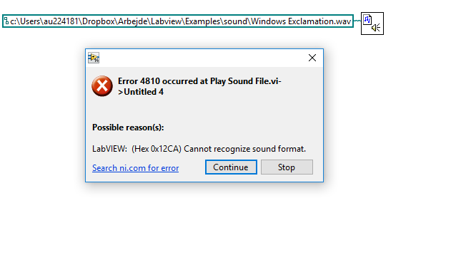

Can not play wav file using labview 2016, Error code 4810
What can the reason be?

Hi Michael,
the reason is given in the error message - what else do you want to know?
It would help when you would attach this WAV file so we could test this feature too (or even check the WAV file format)…

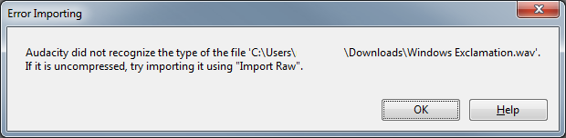

Edit:
I guess it's the default sound file coming with Windows installation.
Even Audacity yells at it:
Conclusion: Use WAV files with default uncompressed encoding with LabVIEW…
