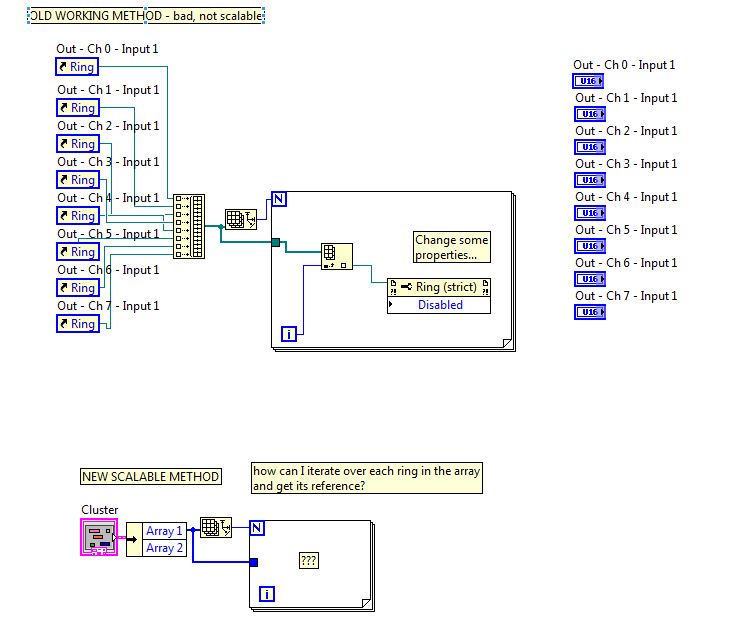

@chucklippmeier wrote:
I'm looking at the Panel->Controls[] property that exposes an array of references to all the controls on a panel.
Is there a way to specify a certain subset of the array of controls?
For instance, I have 100+ controls in the VI I'm working on, but I'd only like to iterate over, say, 10 ring controls (to enable/disable them based on a certain condition).
I know it's been a while since this thread was active but I'm hoping someone will be able to help! Or even better, that labview has since added functionality to support this (I'm using 2011, by the way).
Thanks!
Message 8 of 12
(4,121 Views)
For that few controls, I would just create an array of their references.
You could filter the list based on data type or what not, but that can quickly get involved.
Message 9 of 12
(4,117 Views)
That was very helpful, and simple to implement (don't know why I didn't think of that before!).
Now the problem I'm having is I have a 1D array of ring controls within a cluster, and I need to iterate over the array and get the refnum of each ring.
I know how to get the refnum of a ring when it's not in an array, and I know how to get the refnum of an array, I'm just having trouble iterating over the array and programmatically getting a reference for each ring.
Note: for the purpose of scalability (is that a word?) the rings need to be in an array.
Message 10 of 12
