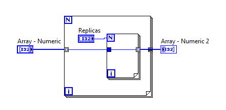

Hi findout,
that is a question that you can solve by reading some free tutorials, but I am going to show you a very simple example of how you can do it (if your LV version supports the auto-indexing).
Hope it helps, regards!

@Luis32 wrote:
... show you a very simple example of how you can do it (if your LV version supports the auto-indexing).
All LabVIEW version support auto-indexing. Older version don't support he concatenating output tunnel you are using.
Also, the "replicas" control belongs outside the loops, it should not change during exection.
(5,493 Views)
Thanks. I created a similar VI with additional Reshape Array function to convert the output into a 1d array.
