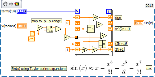

@Yamaeda wrote:
I had to try it for funsies. It's quite impressive how well it hits the target just with n=5.
Yes, it is pretty good. In my old post, I claim that with 14 terms we get within 1e-15 of the correct values.
TaylorSine
Message 17 of 26
(2,641 Views)

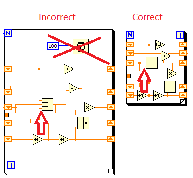

You gave me the solution, but I think I missed something. I am getting the wrong output. Can you check what is wrong? I am new to this.
Message 18 of 26
(2,622 Views)
did you notice the inversion circle on the lowest input of the middle compound arithmetic node? Right-click the terminal and select invert, resulting in a division. The rest is correct.
You probably also want to remove that wait. Makes no sense to have it there
Btw, my code is posted here. (Also, the above image is a snippet)
