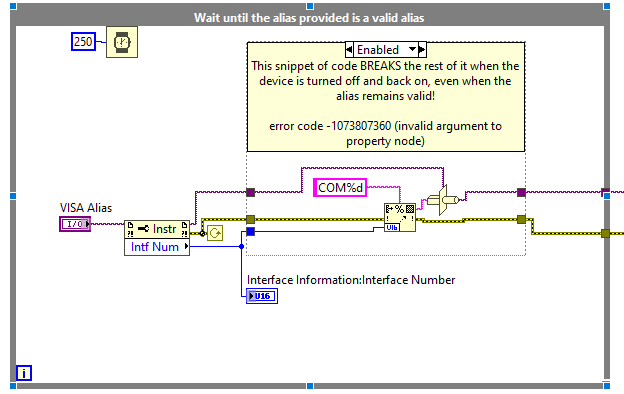

- To do this, we implemented a caching mechanism, which involves converting the alias to its COM port equivalent (through the Interface Number property)
- The device is connected directly to our PC via USB cable, not through a hub, and the USB Selective Suspend is disabled, per: https://forums.ni.com/t5/LabVIEW/Unknown-System-Error-in-VISA-VISA-close-questions/td-p/3227916?prof...
- Before converting the alias to the COM Port equivalent, we're able to power cycle the device, and the alias we use errors briefly, but recovers and functions normally (with no real intervention other than polling VISA open/close)
- After converting the alias to the COM Port, this no longer works.
I've attached a minimal example, for which you'll need to download the KD Scientific 2XX lvlib from the "Find Instrument Drivers" dialogue under Tools > Instruments
I want to say, the issue is NOT with the driver itself (I know this will be brought up), as it's merely VISA Open -> VISA read/writes -> VISA close
The issue is in converting a VISA Alias to a COM Port (see the diagram disable structure in the "Init" state)

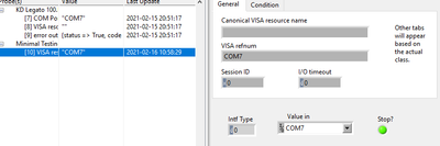

Sadly there's no change on my end! Here's what the probe looks like:
and the COM port did not change when I powered it back on:

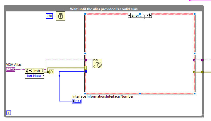

Can you try the following?
If you get an error with your VISA Alias, Use the Close VISA Function to Close the ALIAS, then try to query it again.

Check the provided minimal example, there's a VISA close on error, eg there's not "sad green busy computer" symbol in the VISA alias.

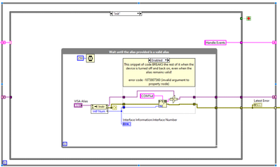

This is what I see in the example
This is what I meant, but it seems you already tried it?

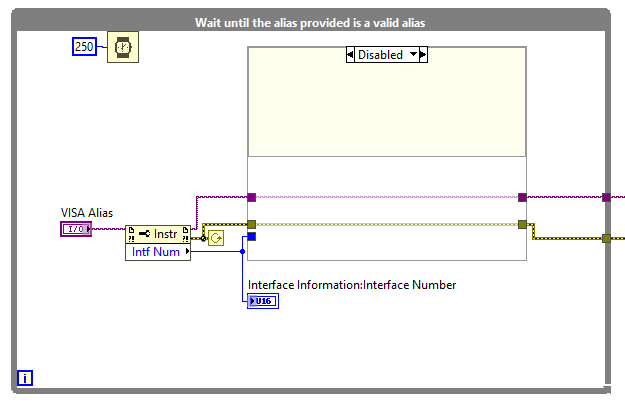

Ah, I see! That's just a polling mechanism. The code works as expected (eg device power cycle is recoverable) when not using the COM port (the "Disable" case), even with the polling mechanism in place. I can try that though.

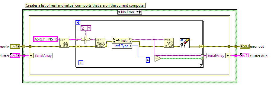

Why don't you try a different tact?
You could modify something like below. Keep listing/finding the ports, until you have the one you are looking for.
mcduff
Message 9 of 13
(2,646 Views)
No real need to open up the sessions...
And, yes, I will just wire the desired string straight to the VISA Configure Serial Port.
NOTE: I made this VI specifically for discovering a serial port from connecting a USB-Serial device.  That is why I am doing the filter.
