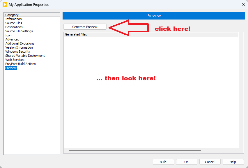

Can you remove all these "always include" items again and show is the built preview instead?

Also, what is built preview?
Message 19 of 39
(2,258 Views)
