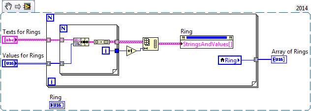

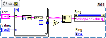

I've been using StringsAndValues[] node for creating a ring with defined values.
I wonder if it is possible to define an array of rings and put different strings-values for each ring element in this array... I've been struggling with this issue but couldn't find a way out. The problem is, property node takes the last value of the loop.
Obviously my approach on property node is wrong. Any alternative thoughts-suggestions?

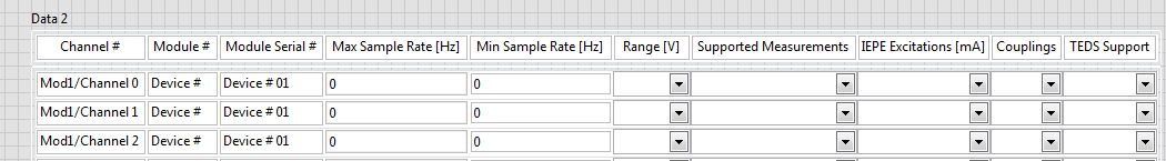

Rings are for the UI. I am creating a table (actually it is a array of clusters) for users to see available DAQ system properties like voltage ranges, supported options etc...
I am trying to use rings where can be different values for each channel. For channel 1, for example, "Couplings" might be AC or DC. I do not see any other way to see that different values in a single raw of an array...
BR, Palazzo

Your second picture shows a misunderstanding:
You set the properties of your scalar ring and read its value using a local variable. Those values are autoindexed into an array of rings - with ring elements independent from your scalar ring…
To set properties of the array ring elements you need a property node of the array element anyway - but still all elements share the same properties, so the FOR loop is senseless then…
