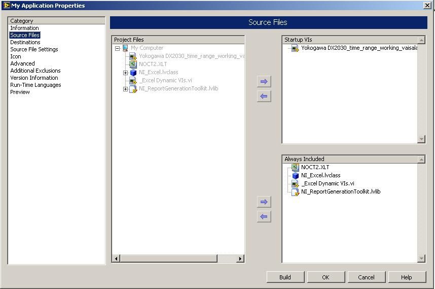

Note : I have added the template, NI_Excel.lvclass, _Excel Dynamic VIs.vi, NI_Report Generation Toolkit.lvlib to the project file and set as always included.

Perhaps to give you clearer view of the problem, here i attach my configuration for the build

The application builder should put your template that you noted as "Always Included" in the "\data" sub-folder. Is it there?
Message 6 of 16
(5,062 Views)
Yup, It's there!

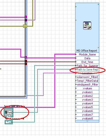

Do you think it's because I wired "path to save report" as control??
Message 7 of 16
(5,059 Views)
If it's an empty path, yes, and you'd never know it because, from your diagram, you're not handling the error output of the express VI.
If your path is fixed, put a constant, otherwise, find an appropriate way to populate the control at run-time, e.g., read from file, prompt the user, etc.
Then wire the error input to the express VI and pass the error output to an appropriate error handling routine or on to the next function in your data path.

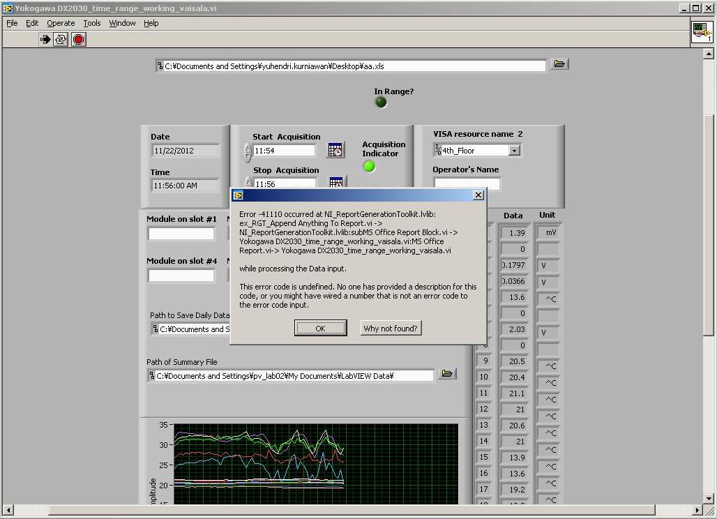

The path is actually defined. and this time I have put error handler to Ms Office report .VI
and I got this error
Btw, Would you mind to list the steps that I have to do to make the application that has custom excel template and "path to save report" control? or simple VI that explain this will be wonderful
It seems like I'm missing something.
Thank you so much in advance 😄
Message 9 of 16
(5,054 Views)
That error is indicating that there is something wrong with a value in your "Data" column.
