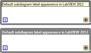

The default style for While Loop subdiagram labels changed between LabVIEW 2012 and LabVIEW 2013:
If you want your While Loop subdiagram label appearance to be consistent across your LabVIEW versions, here are two utilities you can use:
  1. Quick Drop Keyboard Shortcut - While Loop Subdiagram Label - Download this shortcut from the Quick Drop Enthusiasts group to use in LabVIEW 2012. It will create subdiagram labels on While Loops that match the default appearance of labels created in LabVIEW 2013. Note that this plugin will create a left-justified label...you can change the plugin code if you prefer center or right-justified.
  2. Convert While Loop Subdiagram Labels Utility VI - Attached below, you can point this VI (saved in LabVIEW 2013) to a folder of VIs and it will bulk-convert all the While Loop subdiagram labels in those VIs to the default LabVIEW 2013 appearance. This utility VI will not change the existing text justification of the labels. Make sure to back up the folder of VIs before running this utility, as it will make changes to your VIs and save them in LabVIEW 2013.

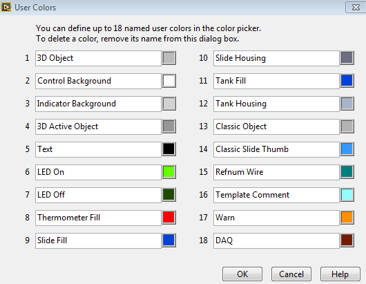

Colors Colors Colors.
Hmmmm. there are only so many "User Colors" in LabVIEW- 18 to be exact.
"Warn" and "DAQ" are MyLabVIEW  I would like a few more! NI has predefined more and more of them over the years.  Not always poorly but, that means that MyColors have shrunken to two.  MyColors for "Skipped", "Error", "Aborted", "Cancled"...... have all gone away.Smiley Sad
Message 8 of 9
