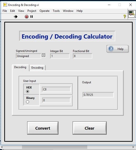

I have an example:
U9.1.8
By entering the Integer and Fractional bits, my calculator is getting decimal number of 0.78125. However, if i am using others tool, the result is 0.77902.
I am not sure can I get the exact decimal number or not.

U9.1.8
U = Unsigned
9 = Total bits
1 = Integer bits
8 = Fractional bits
The example shows decoding from the above format from HEX code (C8) to decimal number.
I am thinking whether can decode the decimal number to nearest to ceiling / floor number.

Hi Juliana,
your result seems to be correct:
Or try this:
When you want to get the next possible values of your FXP numbers you need to count up/down your input value for one LSB…

Hi Juliana,
Actually i also not too sure what tools they (other team) are using.
Why don't you ask "them" - whoever that is?
May i know what tool that you are using to get 0.77902?
As you can see from my images I get the same value of 0.78125 as you do.
