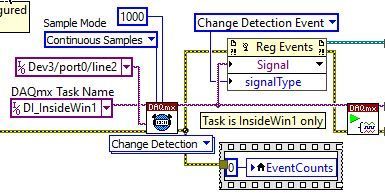

I have hardware differences between machines, but they all run the same LabVIEWapplication.exe
Hardware pins are defined in MAX as Task Names, as shown in the picture below.
I've started using the edge detection feature of the PCI-6515 card, but I cannot figure out how to define a physical channel in MAX for the edge detection input of DAQmx Timing.vi, shown below as Dev3/port0/line2. In MAX, task name "DI_InsideWin1" is defined as Dev3/port0/line2 but Task Names cannot be connected to the "falling edge physical channel" input of DAQmx Timing.vi.
How do I define that input in MAX such that I can deploy the same exe to all machines?

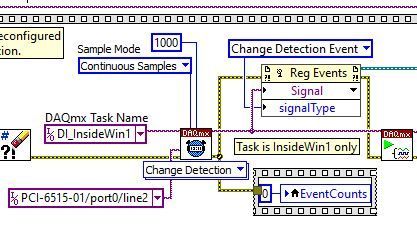

many thanks, seems obvious now.
have tested the code and can confirm this works.  The Physical channel PCI-6515-01/x/x appears in the browse window when you click on the Physical Channel Constant.  I will now need to update MAX on all machines to name the Dev3 card as "PCI-6515-01".

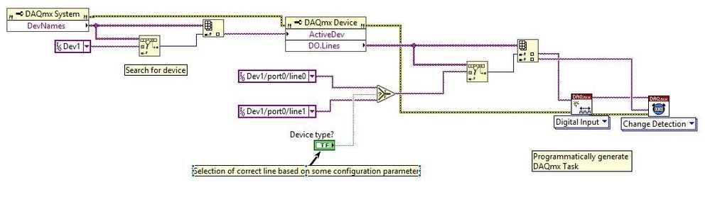

Hi bmann,
instead of fiddling with MAX on each and every computer I prefer to search for the daq device using DAQmx property nodes...
You can also define DAQmx tasks within your LabVIEW project: also no need to work with MAX.

Hi bmann,
@bmann2000 wrote:
The LabVIEW application uses edge detection.  The Digital Input for edge detection is PCI-6515-01/port0/line0 on one machine, but is PCI-6515-01/port1/line0 on another machine.
Why do those machines differ at all?
Anyway: your VI can also determine the machine it is running on, either by checking some properties of the computer (like computer name) or by reading a config file.
Based on that information you can select the right pin for edge detection…

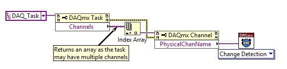

SSP request suggested this method, which does not work.
Then this method, which does work, but suggests using a config file.  This already exists in the MAX .nce file, so another file is not a solution, just a duplication of files.
