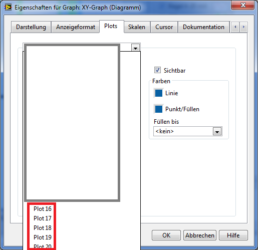

i guess this is a common problem, but I didn't find a solution to this..
Is it possible to delete those additional Graphs createt when expanding the plot legend without deleting and recreating the whole Plot?
See red marker below...
Thank you in advance!

Hmmm... Don't think you can.
Actually, this might be intended behavior. Remember that each plot can have different display settings (line weight, markers, interpolation, etc) and the size of the legend is resizable. I can see where NI would not want to force you to reset all the plot parameters because is was momentarily hidden and then shown again.

hmmm ok, thank you..
it just looks a little bit ugly, that those plots are shown in the context menues of "Snap cursor to" or "fill plot to"

Hello all,
here is the link to support this idea in the Idea exchange forum by kudos:
Make the Legend index a Read/Write Property for Graphs
