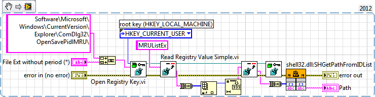

You can find the last file using the following method, the constitution of MRUListEx in registry is not documented (not that I could find anyway) so you will need to use discretion. Also you will need to figure out a way to detect the change event.

Thanks aCe,
I think I'll try that. Can you further explain the "shell32.dll:SHGetPathFromIDList"? The Numeric Array and the String? I'm not sure how to configure those parameters.

That routine decodes the binary data from registry to file path.
http://msdn.microsoft.com/en-gb/library/windows/desktop/bb762194(v=vs.85).aspx
Basically, the first byte of MRUListEx listing in registry is the index of last accessed file in the file list in the sub key. If you open up your registry and navigate to the key, you will figure it out.
Also you can drag and drop snippets on to your block diagram, if that doesnt work, save the png file to your computer and then drag and drop.

Hello again aCe,
I get error -603 "Specified key or value does not exist" after Open Registry Key.vi.
Here is what I have in the String Constant:
Software\Microsoft\
Windows\CurrentVersion\
Explorer\ComDlg32\
OpenSavePidlMRU\
For File Ext without period (*) I have "DAT". (no quotes)
The file extension in question is DAT.

What happens if you try * or jpg in the extension field?
I suspect you are having trouble becuase dat extension may not be assigned to a program and hence there is no entry in the registry.
