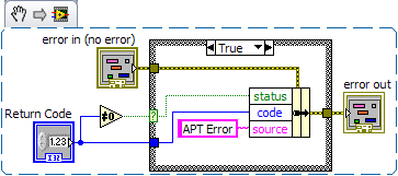

Hi ARay,
here's ReturnCodeInsertion:
19673i3B1BFB504368765C
In the False case the error is just wired through...
