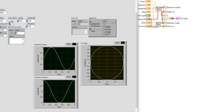

try  generate 2 sinusoid functions, shifted of 90 degress on phase, and bundle to plot on  XY graph

here's a rube goldberg-ish version by  using labviews built in "plot circle by radius", complex numberes, build cluster array and a XY Graph
note: by updating the radius, the pixel center is set to center_x = center_y = radius

Don't forget to wire a T into the "exclude end?" input on the ramp pattern or you will have a point at 0 and 2pi.
Message 9 of 13
(2,451 Views)
Which is required if we want to close the circle... 😄
(With the end excluded, we would have a gap)
